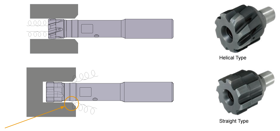

  • Please use a helical type head for through holes and a straight type head for blind holes.
    The helical type is designed to eject chips forward, and the straight type is designed to eject chips backwards.
