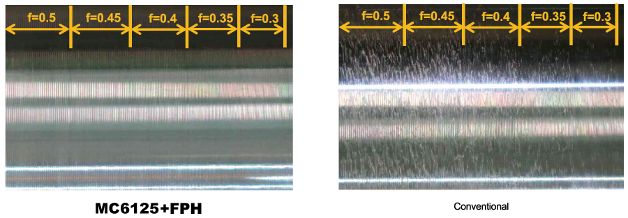

FPH Breaker
The combination of a positive land cutting edge shape and a two-stage protrusion optimises chip generation at low depths of cut, high feed conditions, thereby reducing machining times.
SCM440 : Comparison of Chips and Finished Surface
The FPH chipbreaker has excellent chip breaking properties, Therefore a good component surface finish can always be expected.
Cutting Conditions
Material : JIS SCM440, Inserts : CNMG120408-oo MC6125, Cutting Speed : vc=200m/min
Depth of Cut : 0.2mm, Feed per Rev. : f= The fluctuation values are shown in the image.
Cutting Mode : Wet Cutting
Chip Comparison
Chip Comparison
Cutting Conditions
Material : JIS SCM440, Inserts : DNMG150408-oo, Cutting Speed : vc=200m/min
Depth of Cut : 0.2mm, Feed per Rev. : f=0.3mm/rev, Cutting Mode : Dry Cutting
