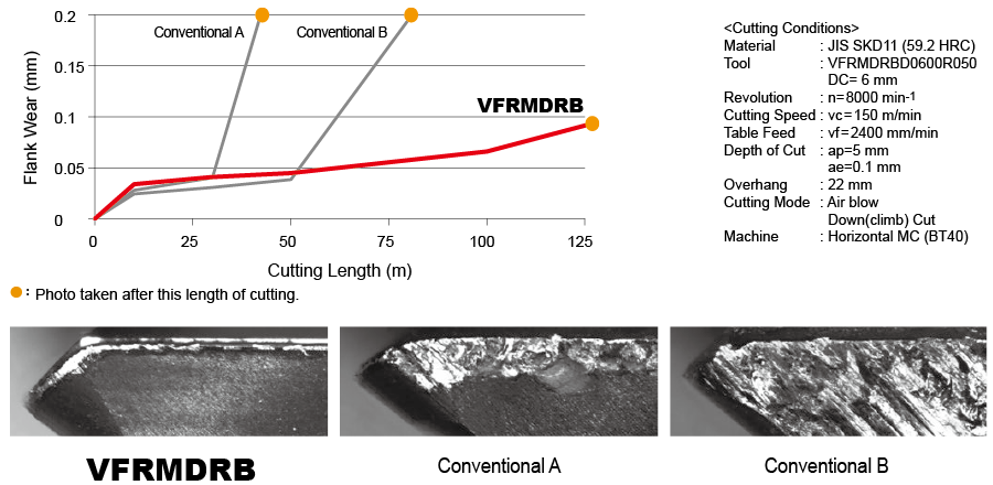

  • SKD11 (59.2 HRC) Tool Life Comparison
Compared to conventional products, more than 2 times longer tool life during stable machining was achieved.

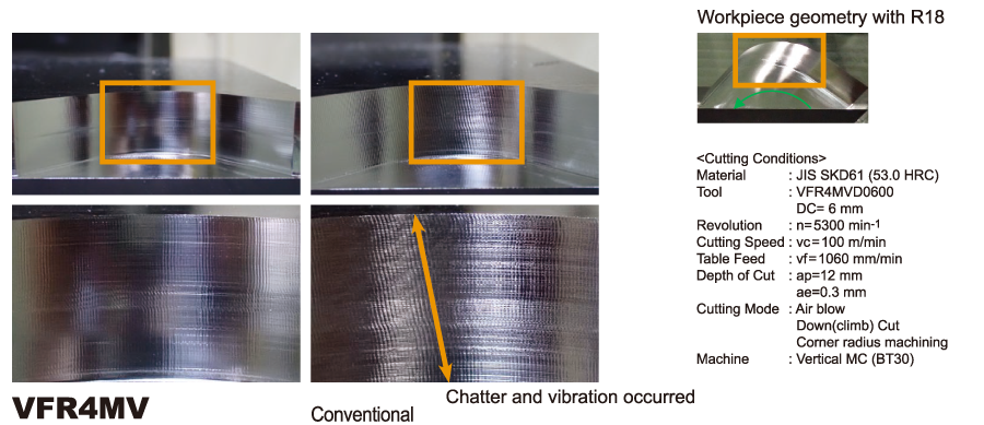

Suppresses Chatter and Vibration and Provides Consistent Surface Finishes
Chatter and vibrations are suppressed through the use of irregular helix flutes and irregular pitch flute geometry pitch, combined with a highly rigid centre cross section.

  • Comparison of Surface Finishes - Machining SKD61 (53.0 HRC)
Demonstrates excellent chatter resistance when machining hardened steel.
