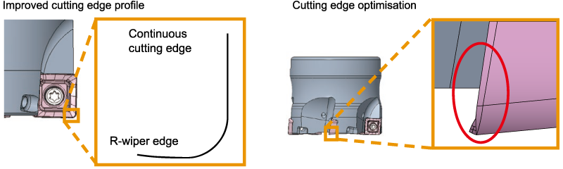

Improved Cutting Edge Ridge
ASX300 inserts have a smooth continuous cutting edge that improves the component surface finish and dimensional accuracy.
Optimised Cutting Edge Geometry
The geometry of the ASX300 optimises the contact with the workpiece. This provides edge strength and improves chip evacuation. The extra edge strength resists damage even under high cutting loads.

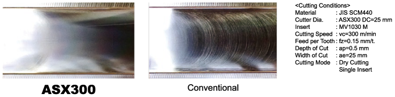

SCM440 finished surface comparison
Achieves a glossy finish without cloudiness.

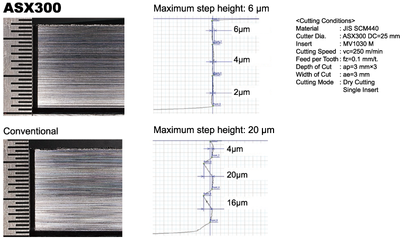

SCM440 : Comparison of wall surface accuracy after shoulder milling
The improved cutting edge ridge reduces cutting steps.

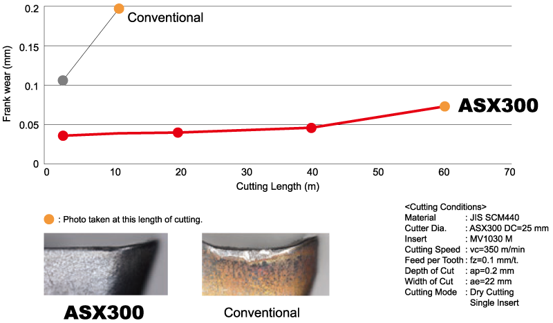

Wear resistance comparison of SCM440
The synergistic effect with grade MV1030 dramatically extends tool life under high-speed cutting conditions.

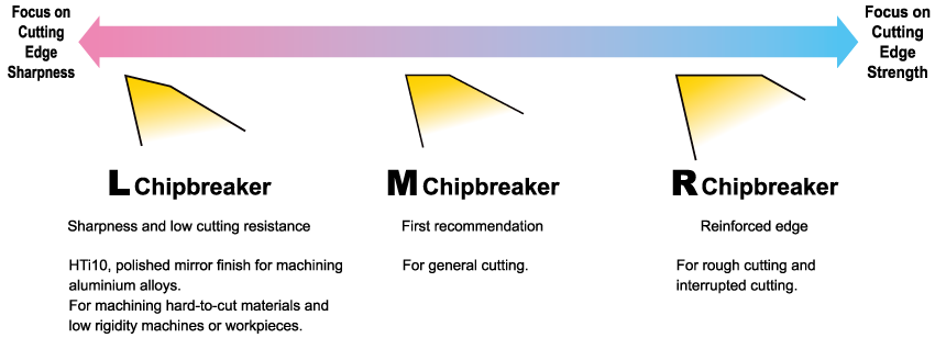

Chipbreaker System
