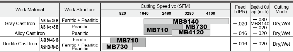

• Suitable for high speed finishing of heat treated steel, sintered ferrous alloy and cast iron.
  • Low affinity to iron, thus good surface finishes are possible.
  • Present grinding processes can now be machined reducing cost and time.

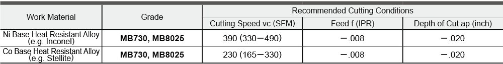

Heat Resistant Alloy
