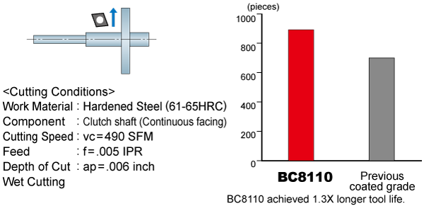

Combination of Coating grade & Breaker, high efficiency and long tool life in wide variety of applications.
Good for deep depth cutting of carburized layer.
Recommend and under ap=.024 inch
Available in BC8120 grade.
Good for chip removal under light depth and feed cutting.
Recommend and under ap=.012 inch
Available in BC8110 grade.
