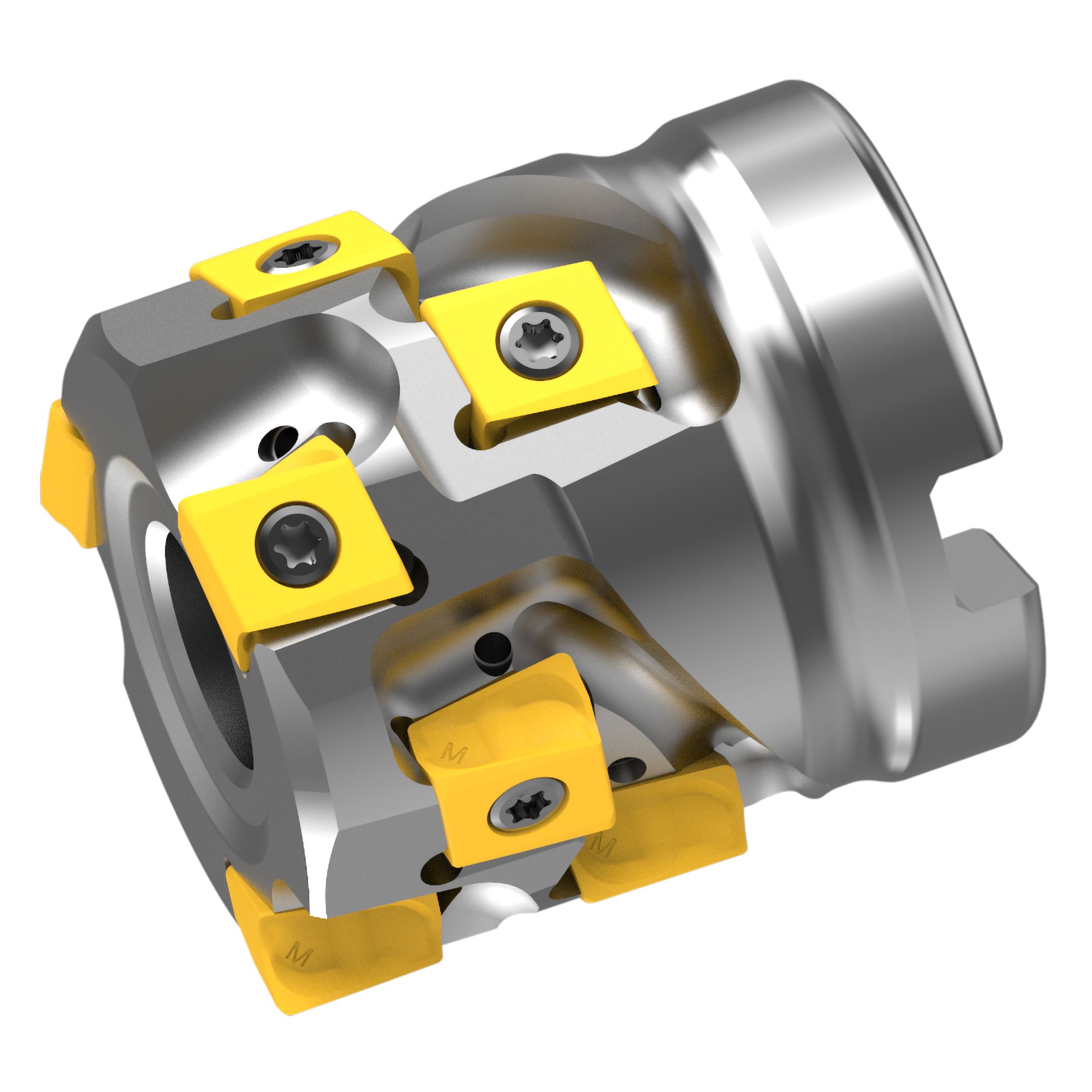

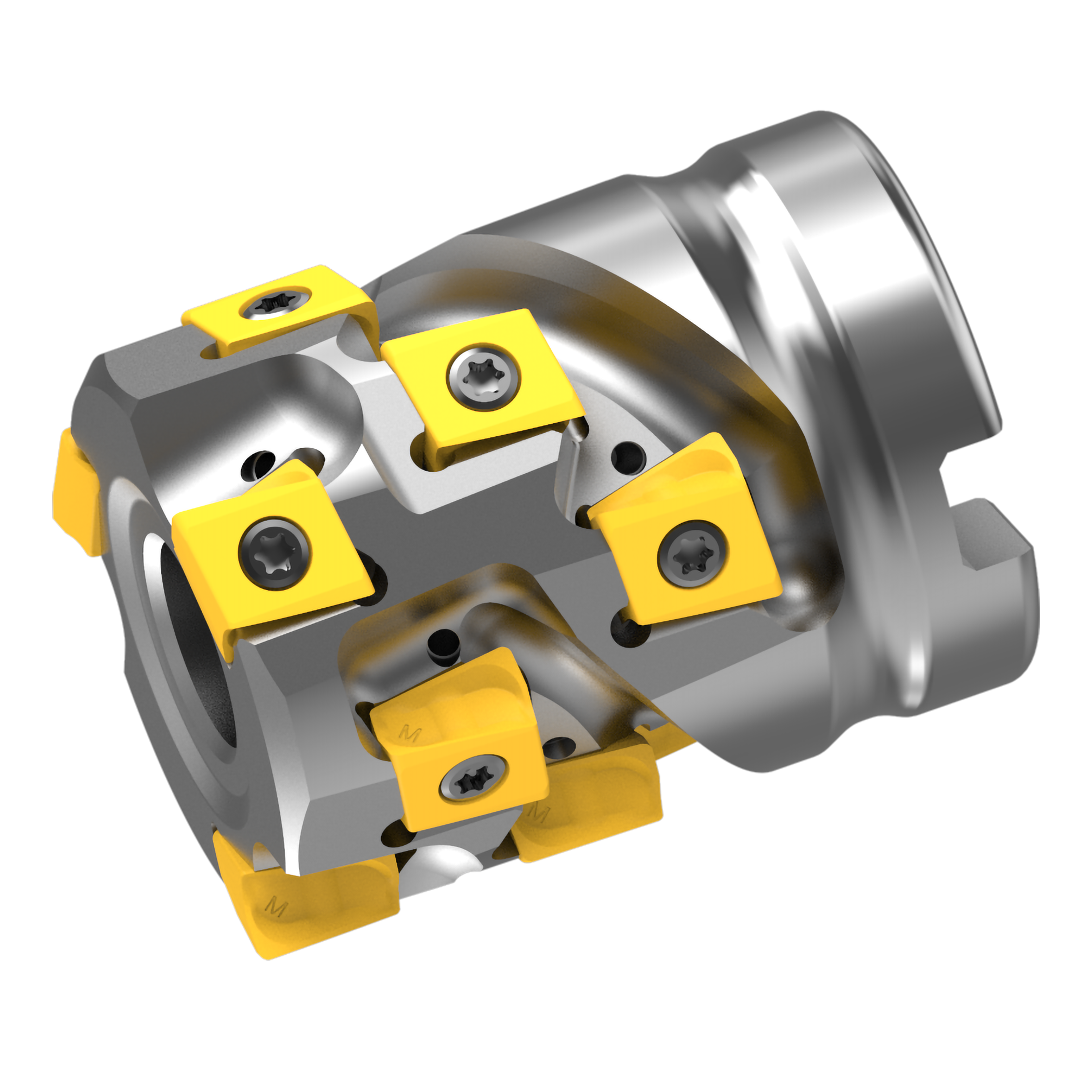

Indexable Milling
Deep Shoulder Milling
VPX300
EDP No:10607268
