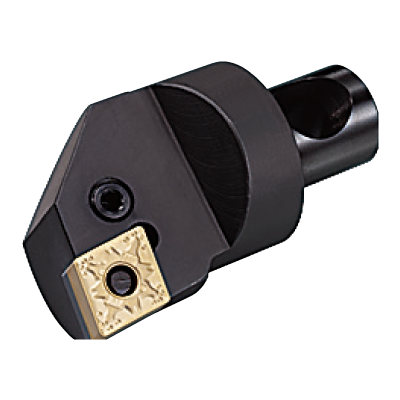

Turning Tools
Turning Holder
Boring
DPCL
DPCL
