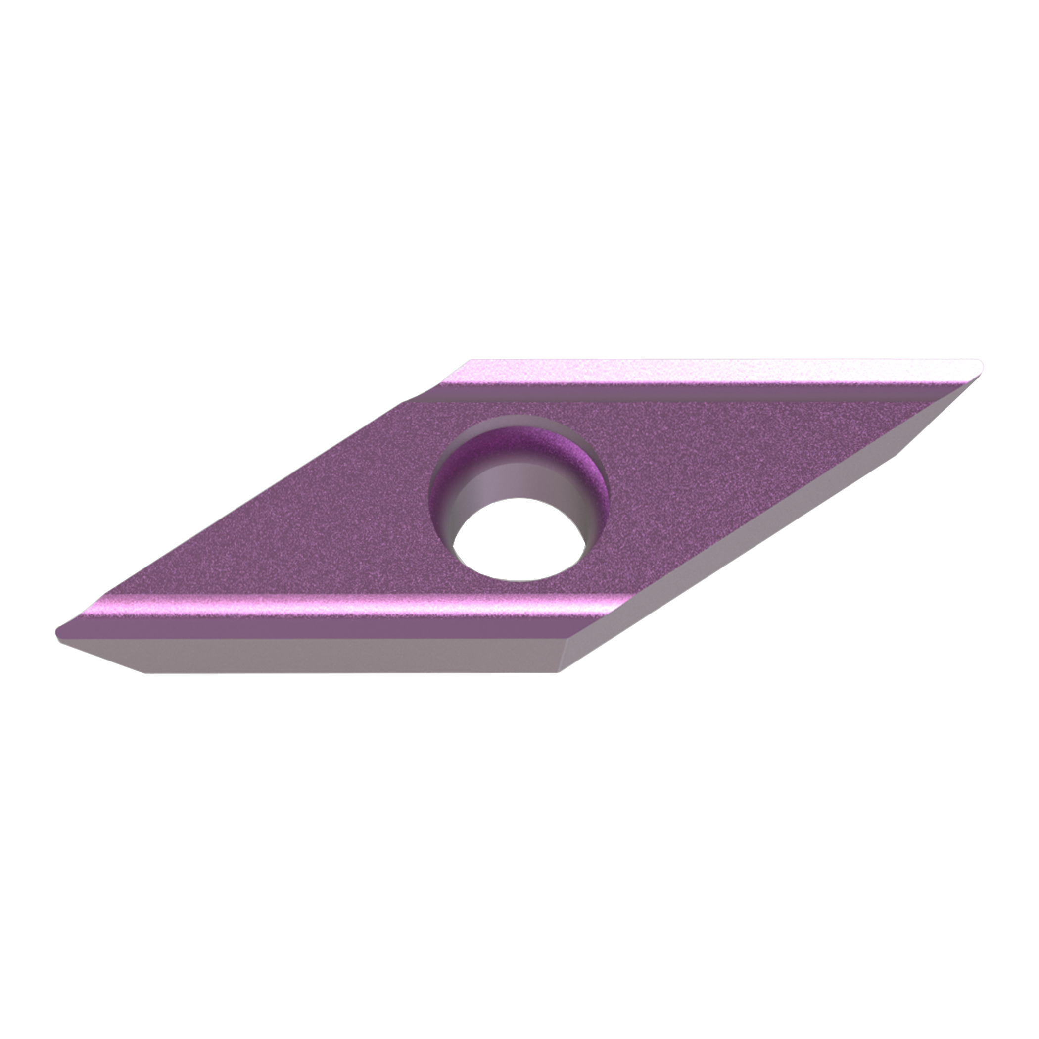

Turning Tools
ISO Inserts
Positive with hole
EDP No:23181229
