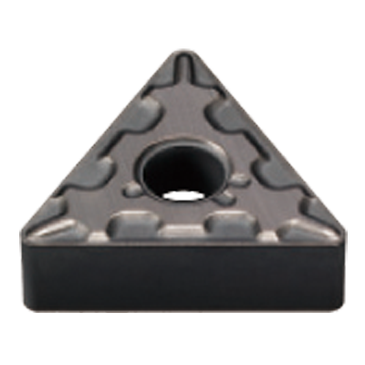

Turning Tools
ISO Inserts
Negative with hole
EDP No:238633
