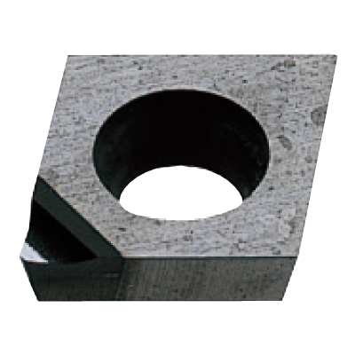

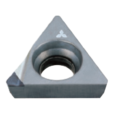

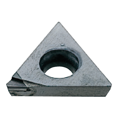

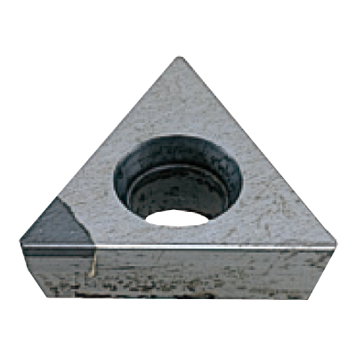

Turning Tools
PCD Inserts
Positive with hole
EDP No:108241
