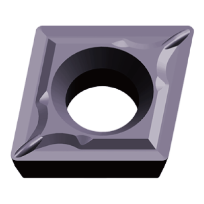

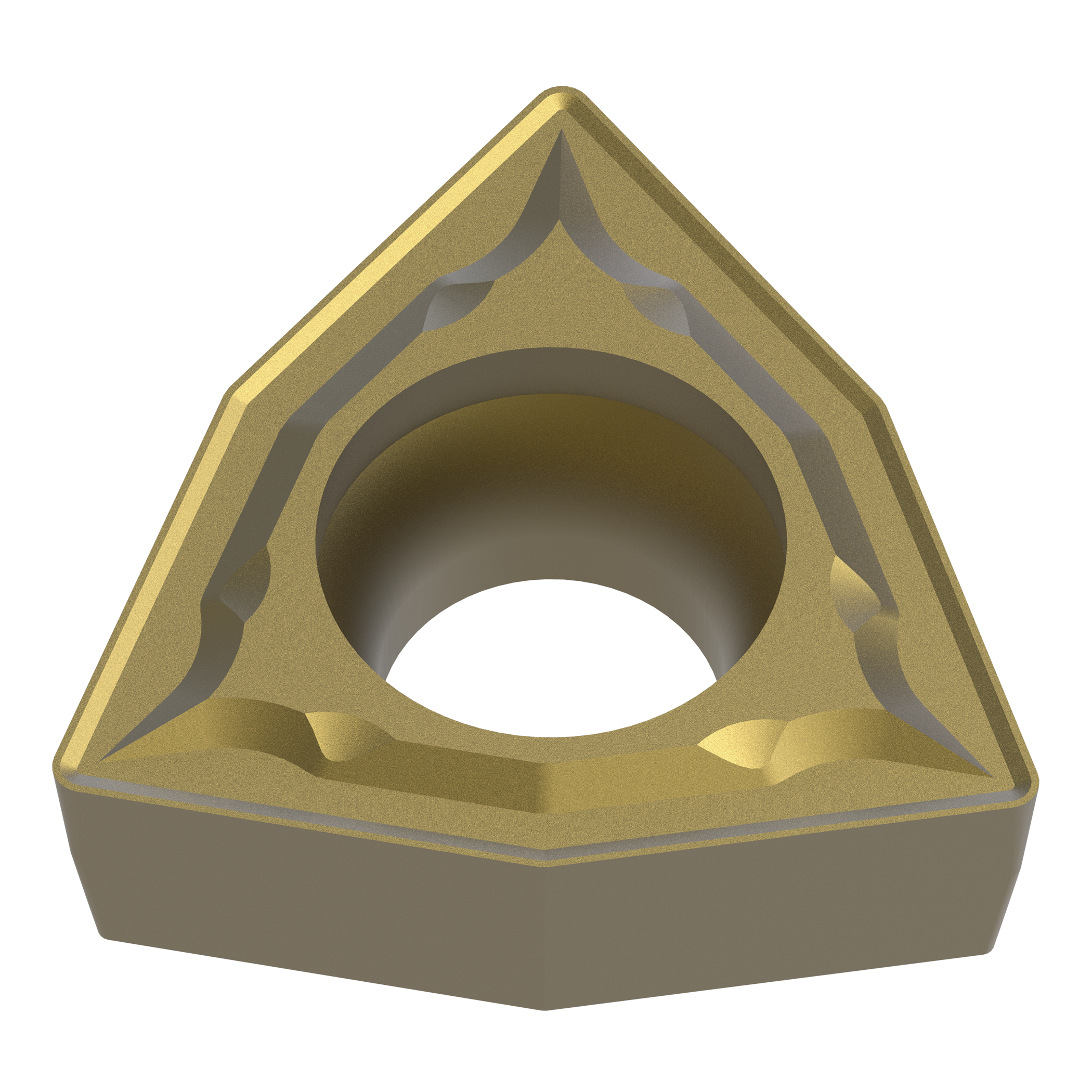

Turning Tools
ISO Inserts
Positive with hole
EDP No:10592816
