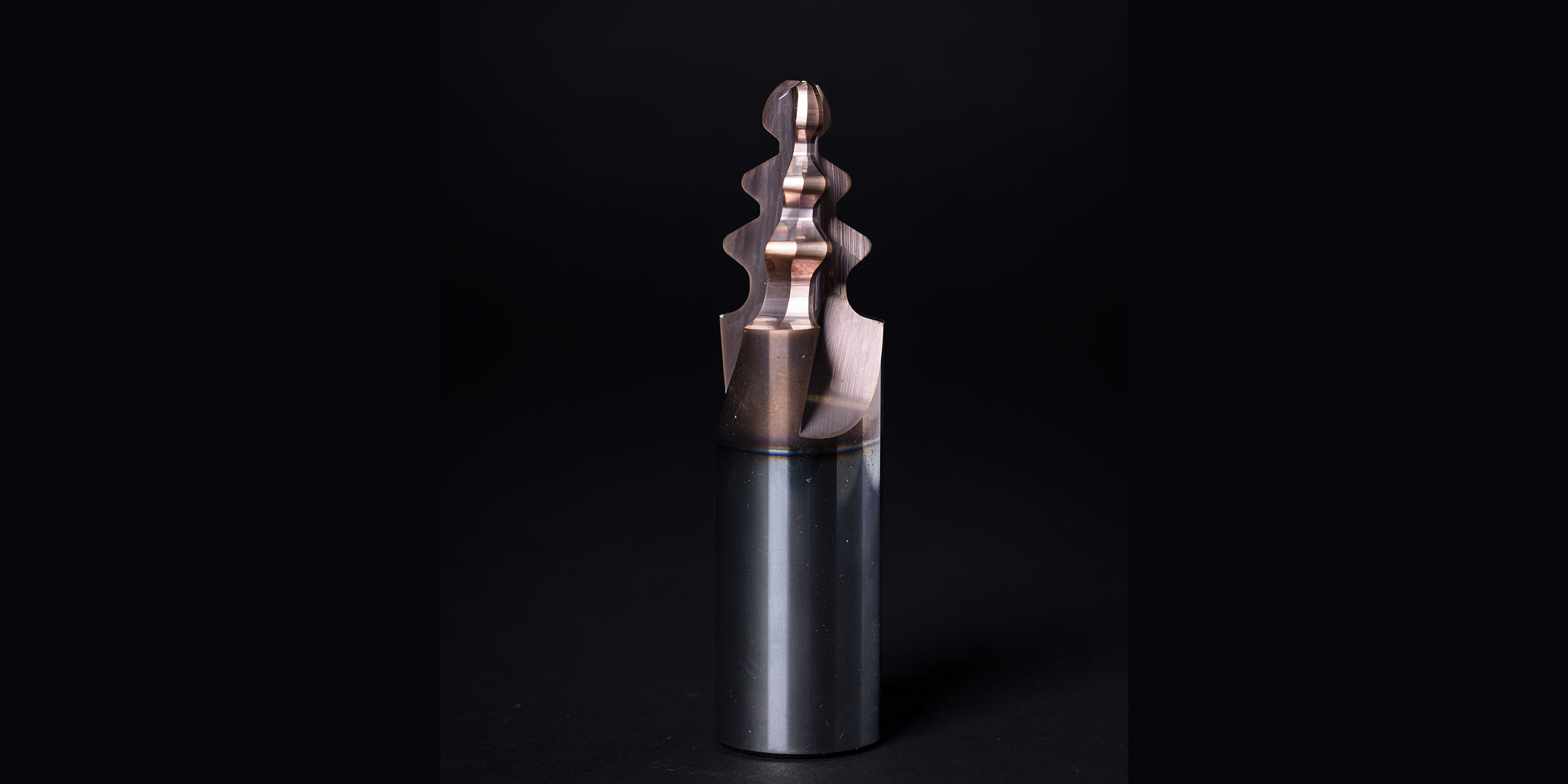

FRESE INTEGRALI
FRESE INTEGRALI

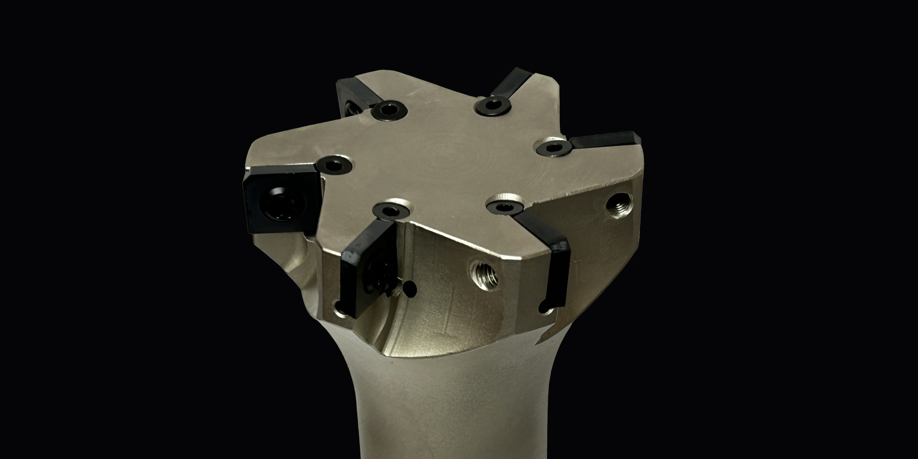

FRESE AD INSERTI
FRESE AD INSERTI

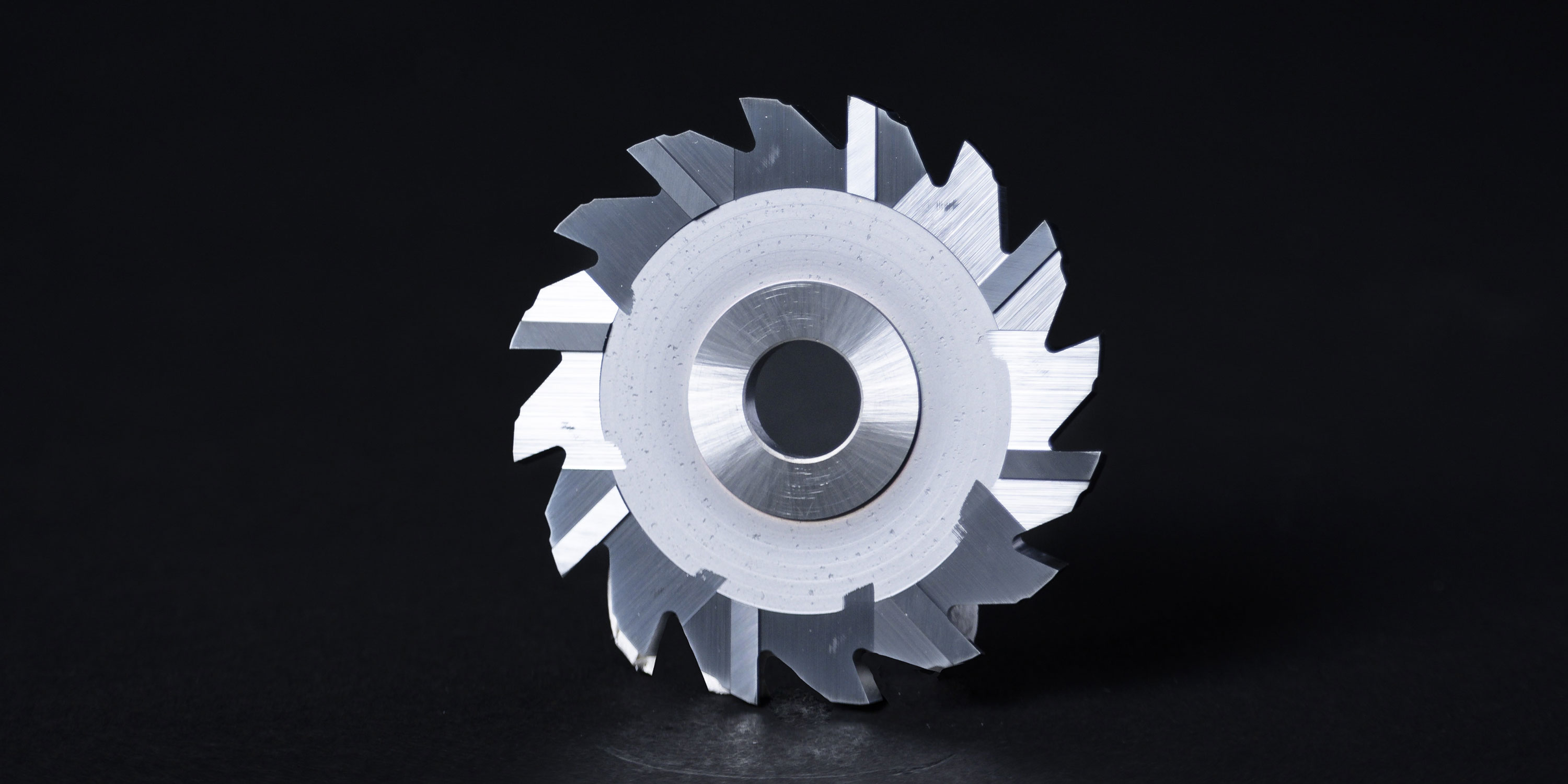

FRESE A DISCO
FRESE A DISCO

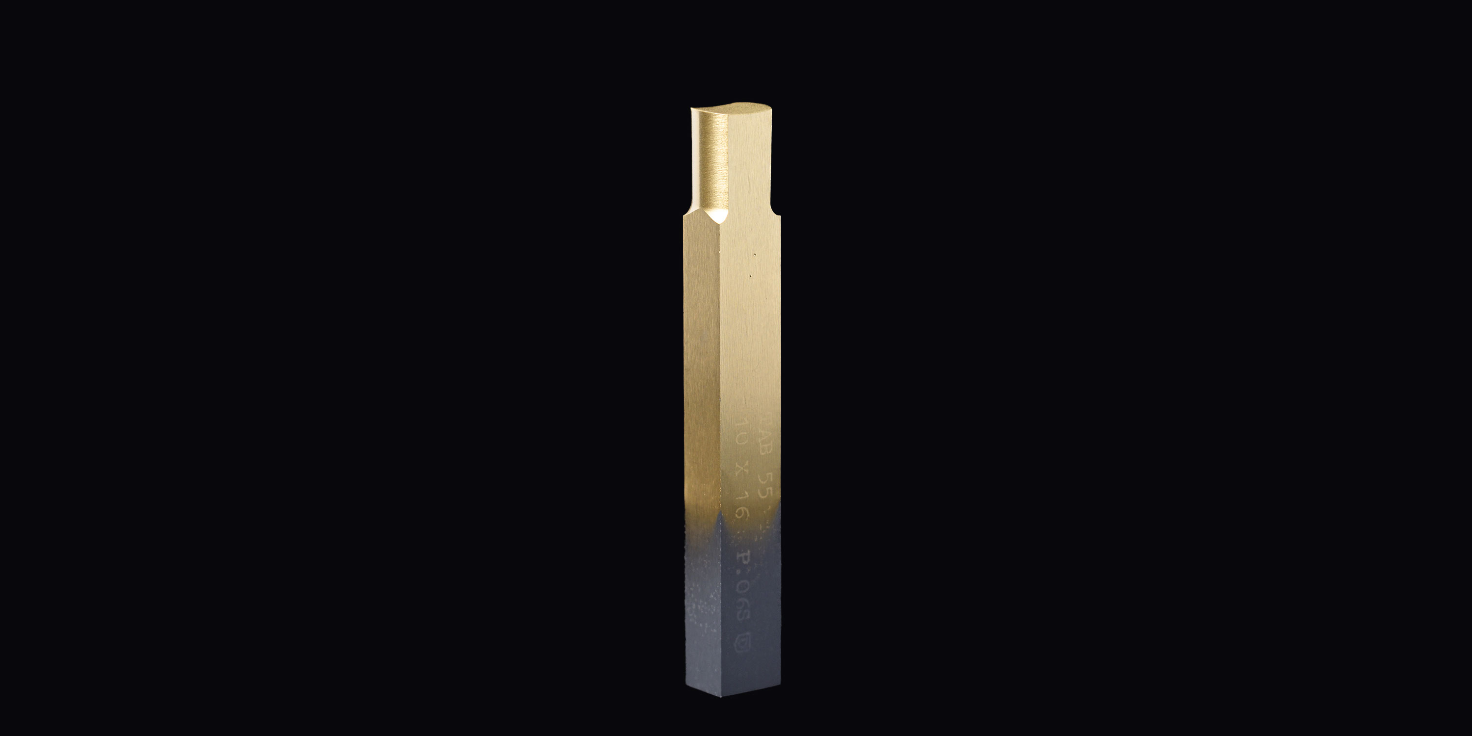

BROCCE
BROCCE

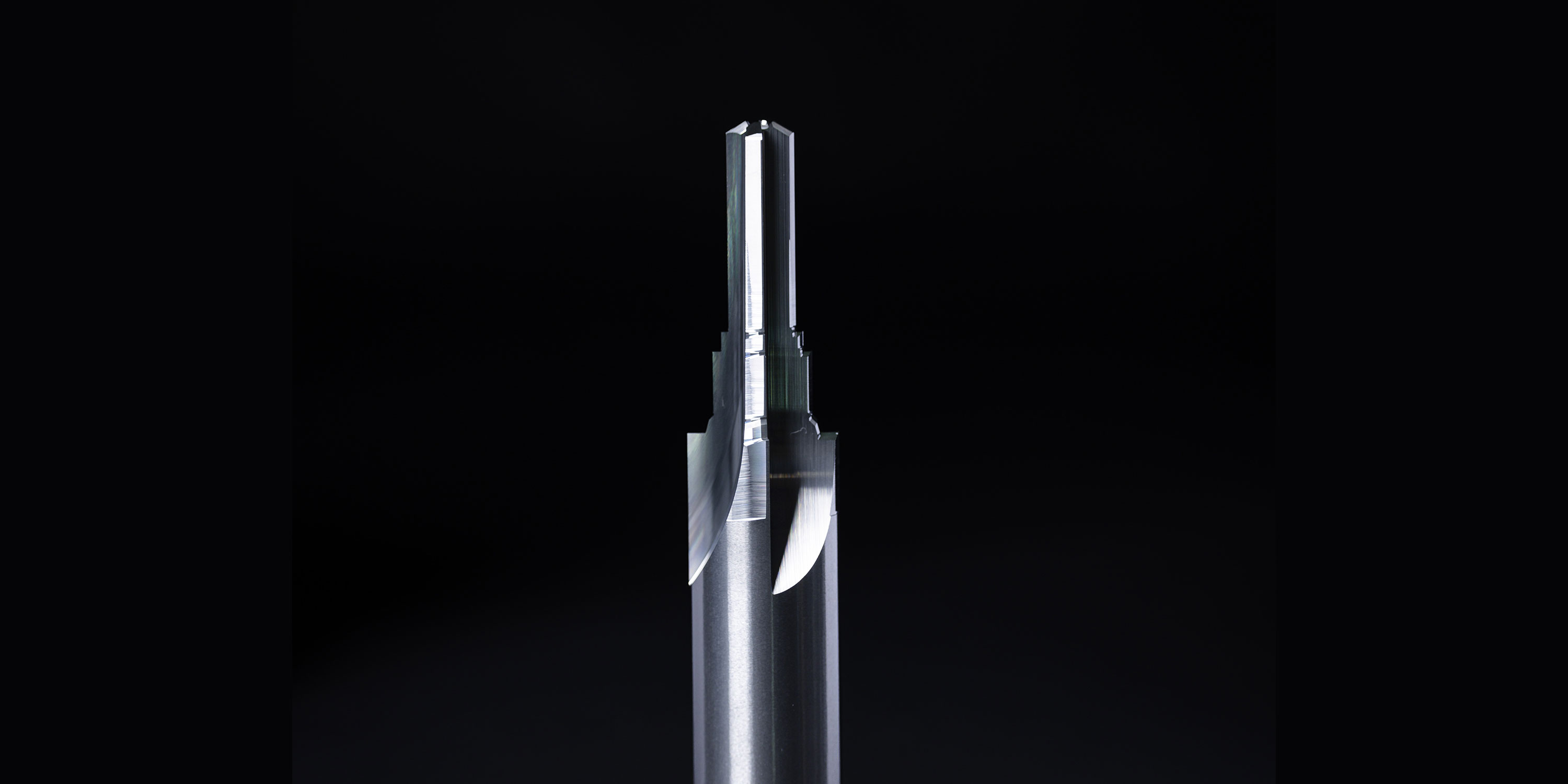

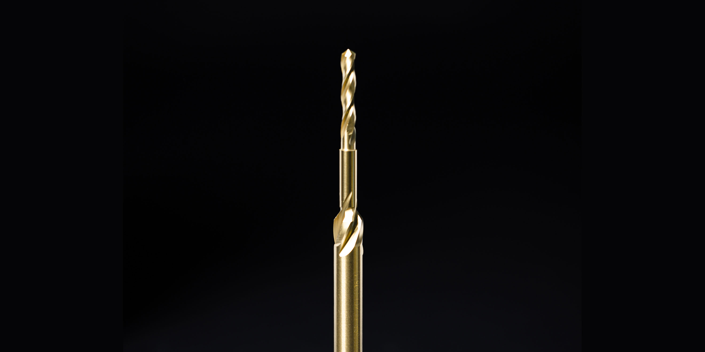

PUNTE
PUNTE

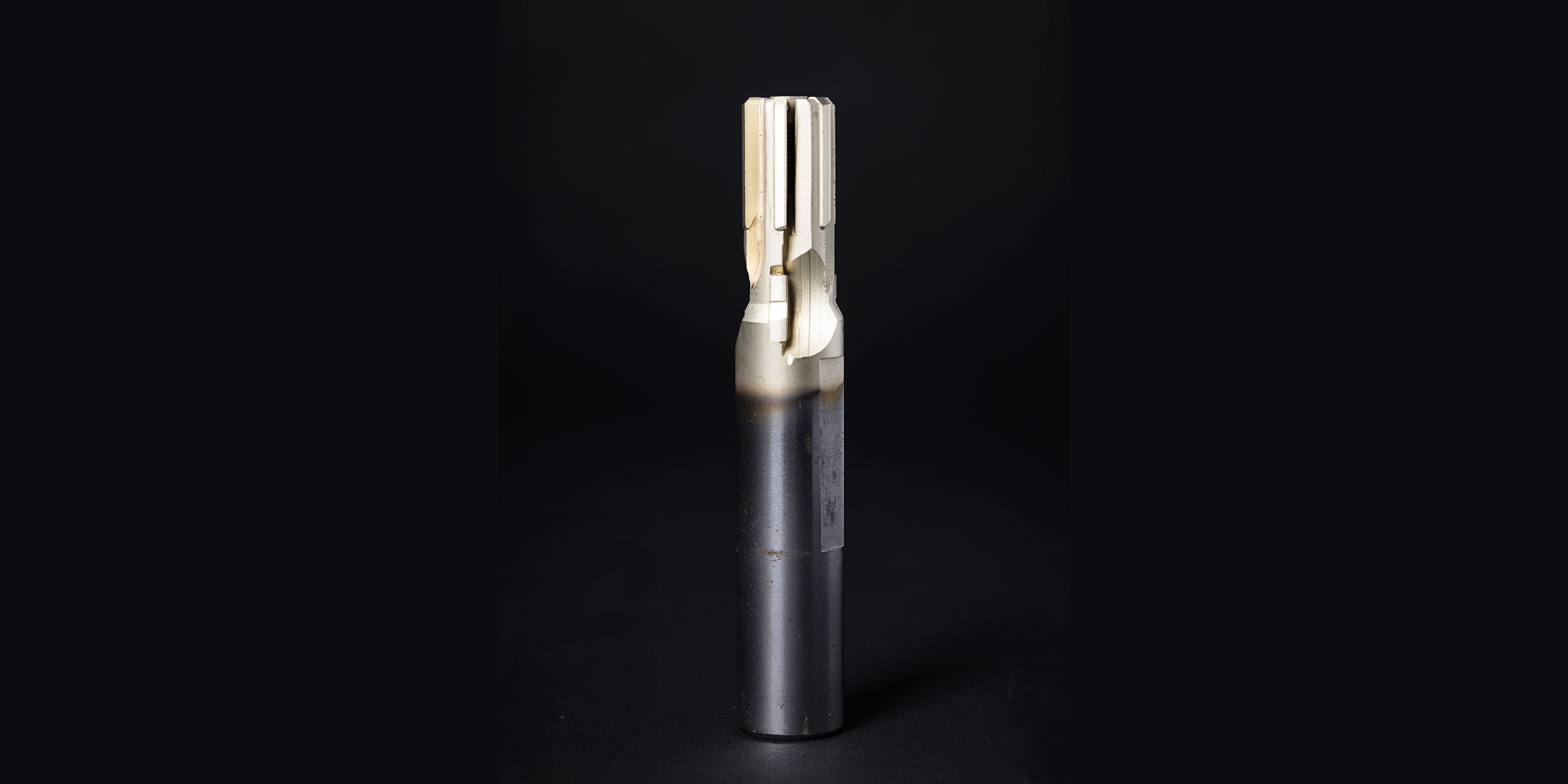

ALESATORI
ALESATORI

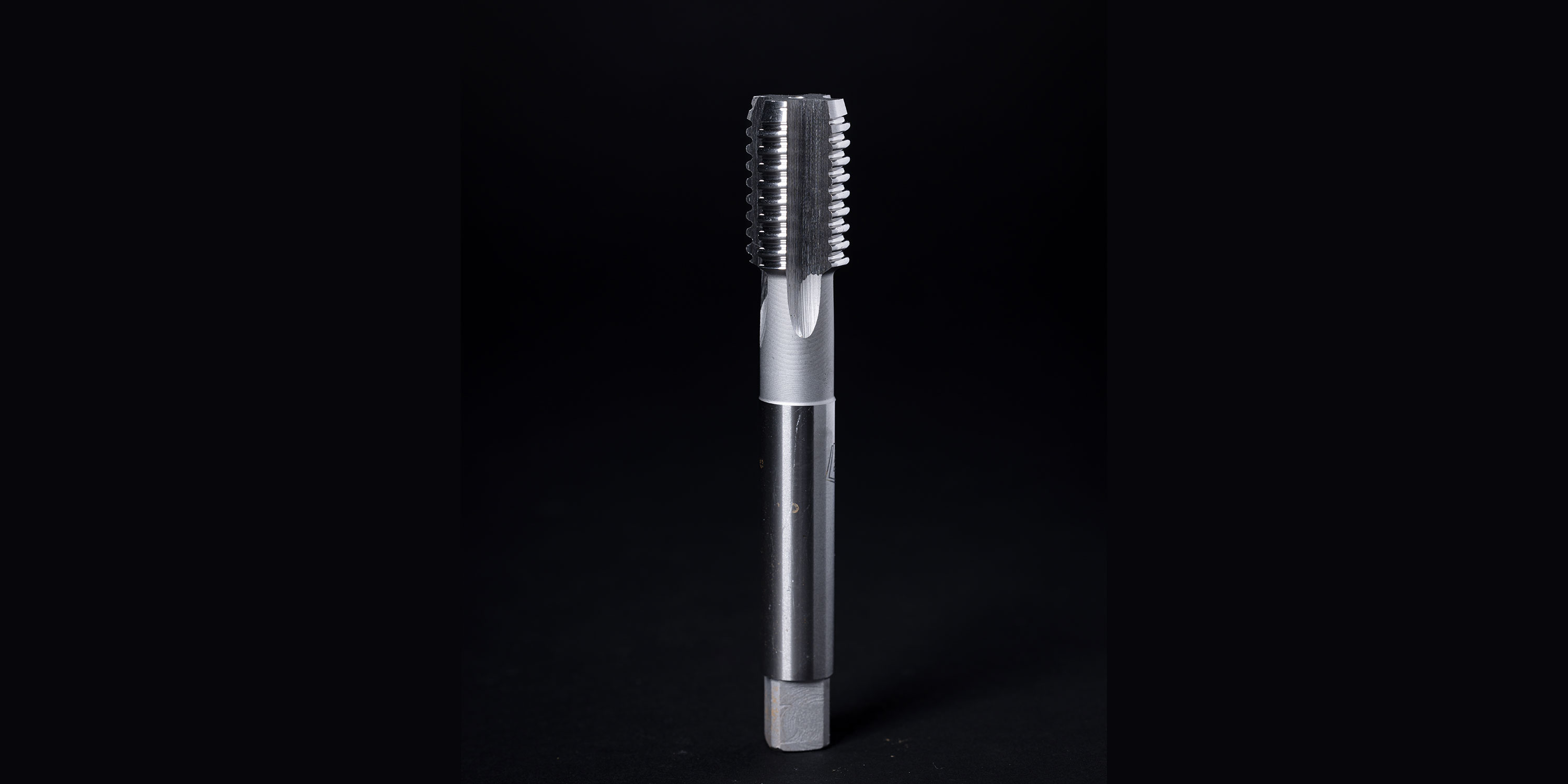

MASCHI
MASCHI
