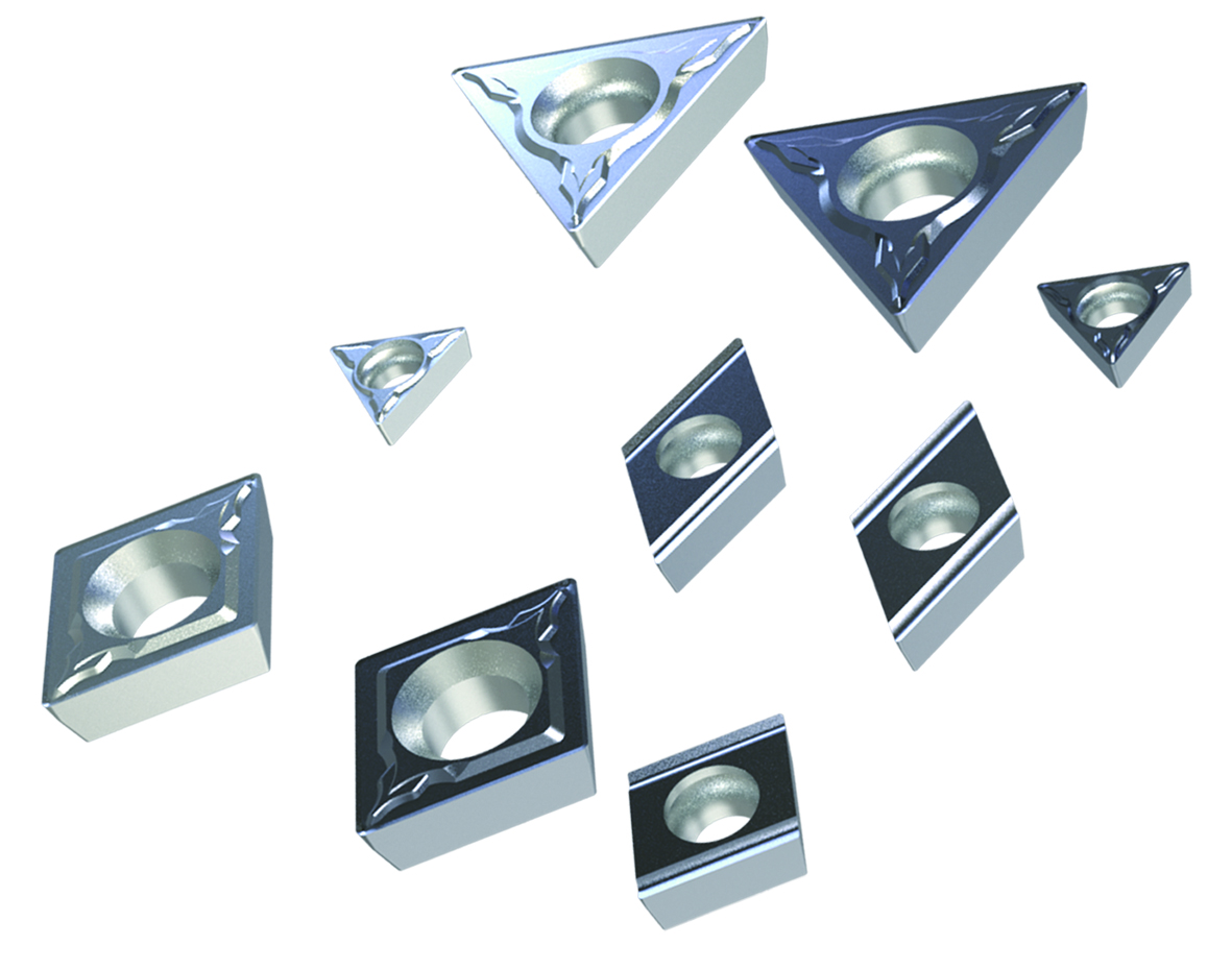

MP3115/MX3115 supports a wide range of steel turning operations including carbon, alloy and mild steels. With a recommended cutting speed range of 150–350 m/min and a versatile lineup of insert geometries and chipbreakers for finishing, light and medium cutting, The 13 different chipbreakers and nine different insert geometries also gives manufacturers the flexibility to optimise performance across multiple applications.
MP3115 /MX3115 is available with negative geometry TNGG inserts and in the positive geometry types CC, CP, DC, TB, TC, and TP. All the positive geometries are available in both M, E and G class, with the exception of the CP range where only M class can be chosen.
