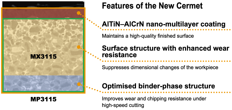

Excellent dimensional stability Sustains a glossy finished surface
Grade Features
Through surface treatment and optimisation of the cermet structure, suppression of dimensional changes of the workpiece and persistence of the finished surface are achieved

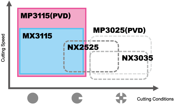

Cermet Grade for Turning
Within the cermet grade range, suitable for high‑speed cutting at vc = 150–350 m/min.

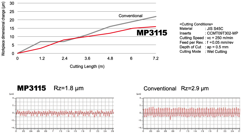

Alloy steel S45C: Workpiece Dimensional Change and Surface Roughness Comparison
Compared with conventional products, surface roughness is improved by 1 μm (Rz) while initial workpiece dimensional change is reduced.

MX3115

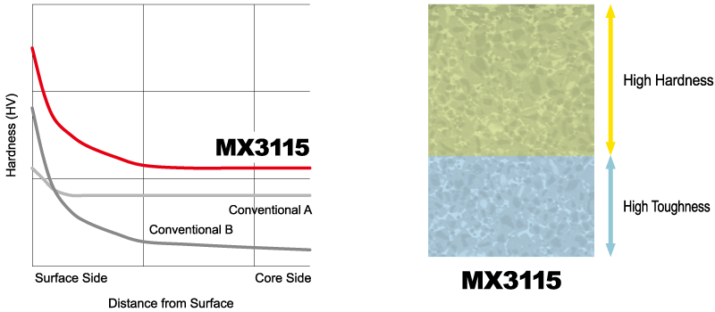

Extremely Hard Surface, Tough Core Cermet Grade
For stable finishing operations, surface hardness is further enhanced, while internal structure is optimised for toughness.

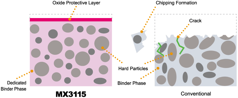

Prevents Sudden Cutting Edge Failure
Oxide protective layer formed during cutting suppresses oxidation‑related wear, while a dedicated binder phase inhibits crack growth and improves chipping resistance.

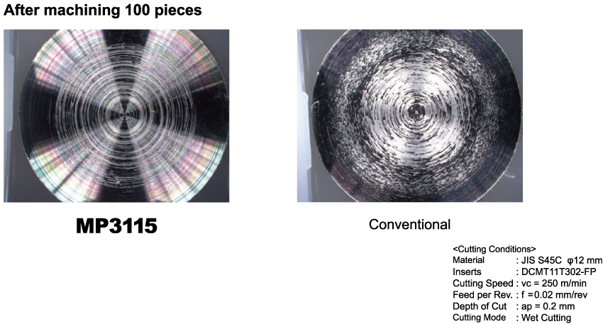

Cutting Performance
Alloy Steel S45C: Comparison of Workpiece Surface Appearance in Facing Wet Cutting
Even at the centre of the low‑speed cutting region, smooth, high‑hardness surface suppresses adhesion and maintains high‑quality finished surface.

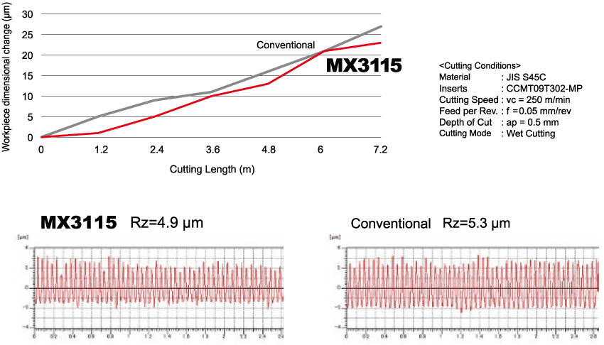

Even without coating, cermet shows small workpiece dimensional change and good surface roughness.

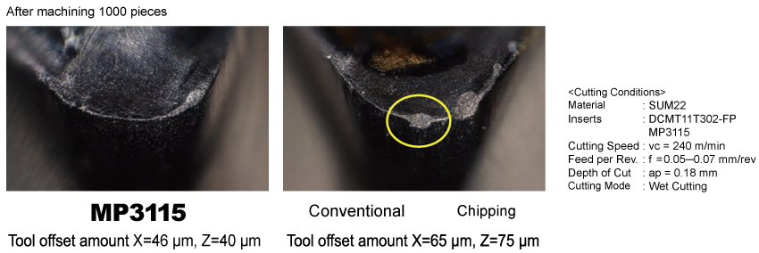

Customer Application Example
Courtesy of Matsumoto Kosan Co., Ltd.
Front Turning

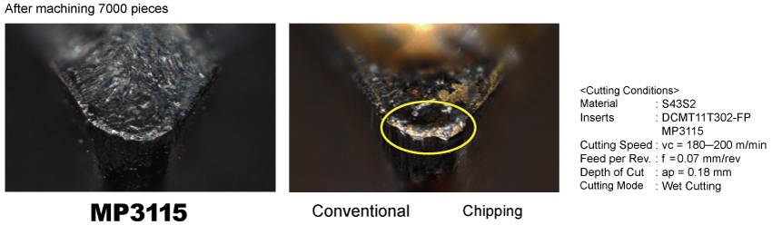

In machining of free‑cutting steel SUM22, tool compensation was reduced to two‑thirds.
Reduced chipping and wear in machining of carbon steel S43S2.
