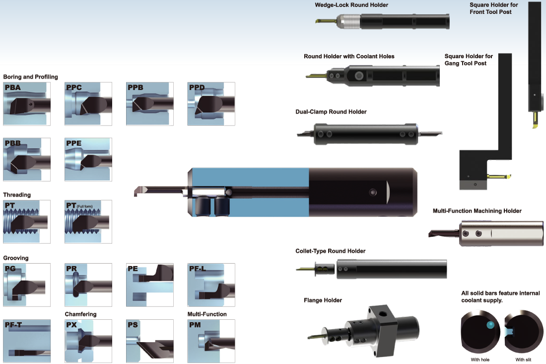

A wide range of solid bars and holders to meet diverse machining requirements.
Easy setup with a positioning mechanism.

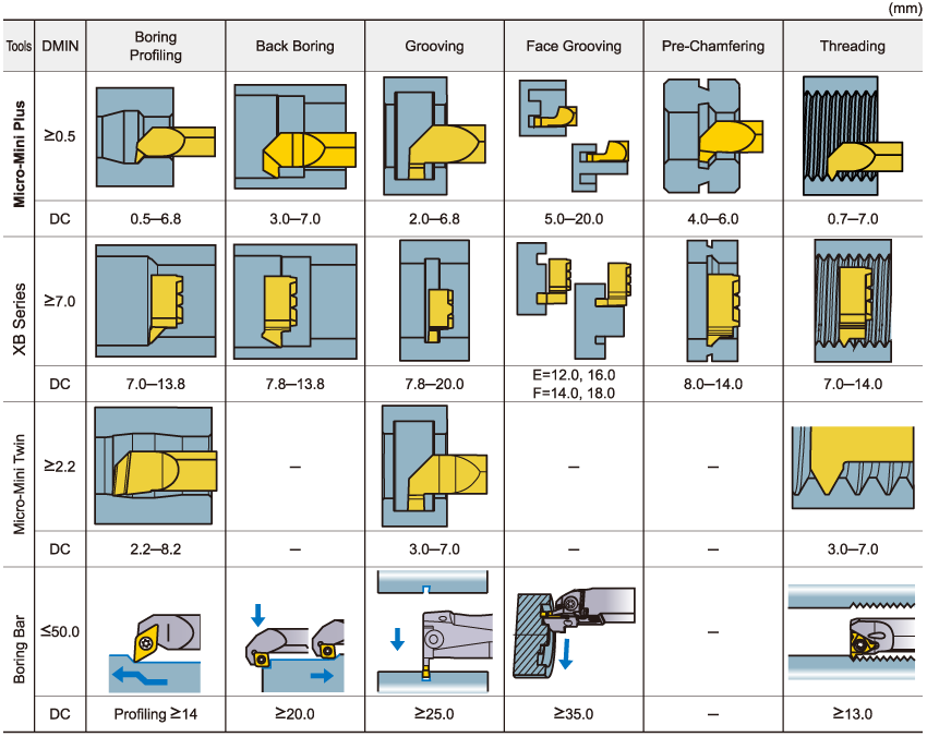

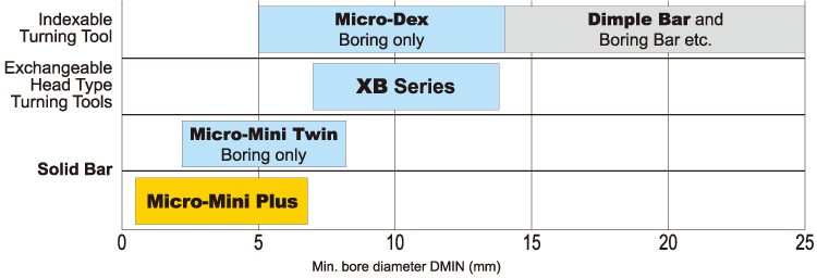

Classification of Internal Turning Tools
With the introduction of Micro-Mini Plus Series, the range of applicable machining operations has been expanded.
Versatile Range of Tools for All Applications

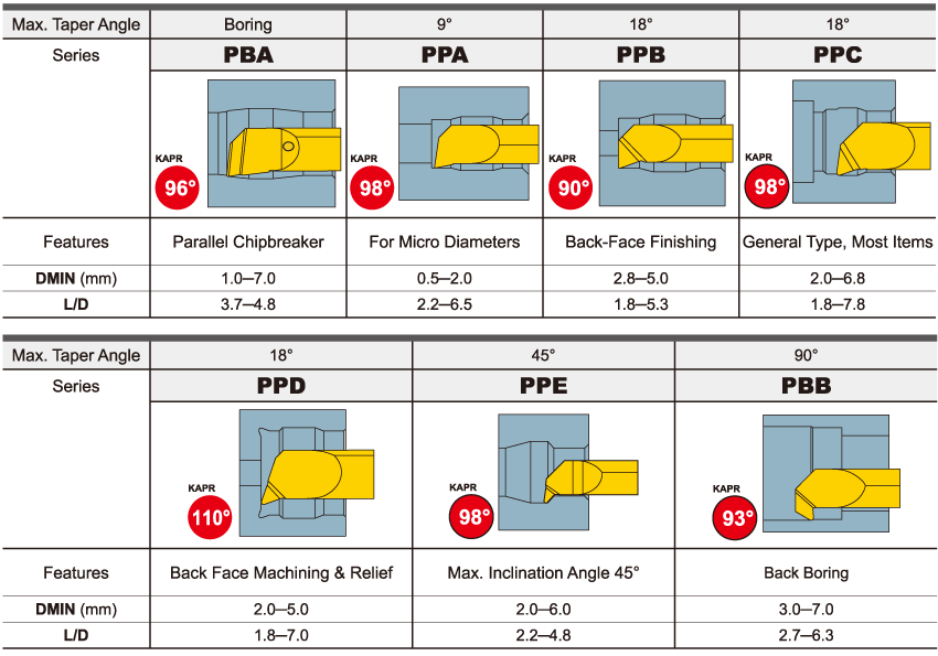

Boring and Profiling

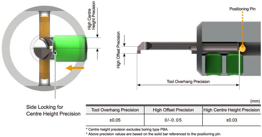

Easy Setup with Positioning Mechanism
Easy positioning is achieved by pressing the shank bottom against the integrated positioning pin.

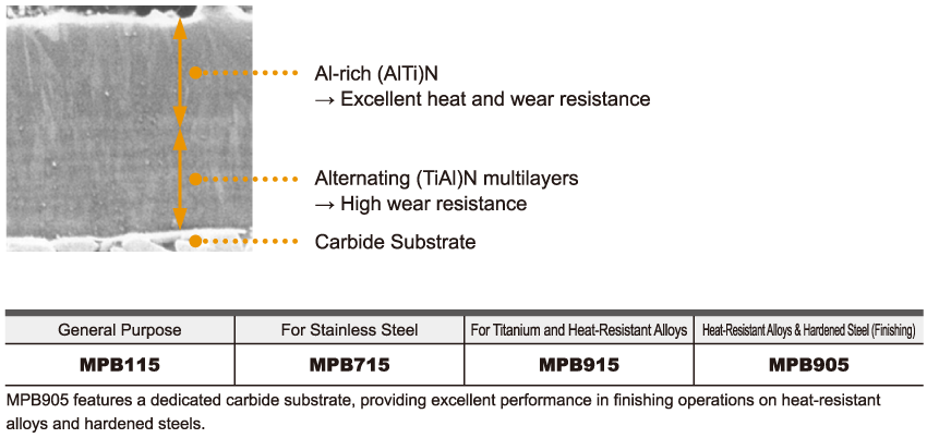

Dedicated PVD‑Coated Grade
MPB115 uses a dedicated carbide substrate for high cutting‑edge stability, together with a multilayer PVD coating that provides excellent heat and wear resistance, ensuring stable cutting and high wear resistance.

Boring & Profiling
Boring & Profiling

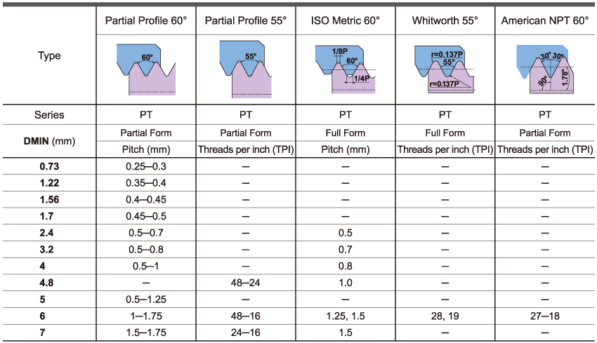

Threading
Threading

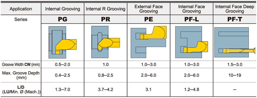

Internal Grooving & Face Grooving

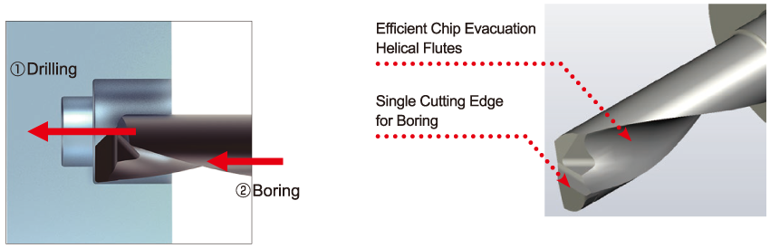

Multi‑Function Machining
This multi-functional type enables both drilling and boring in a single operation.

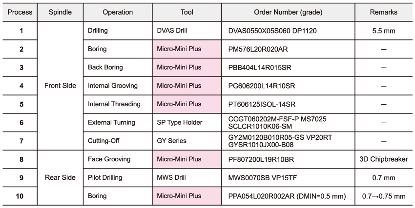

Tooling Proposals
Broader Line‑up Stronger Tooling Proposals
Process 8: Face Grooving

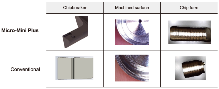

3D Chipbreaker provides excellent chip evacuation and prevents chatter and vibration.
